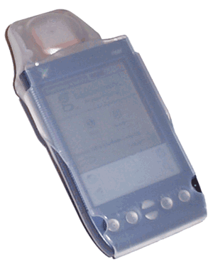

  • Geode in VPR with hard cover onNow for the details.  The Geode uses a SiRFstar II based GPS receiver with FoliageLock technology that improves accuracy in areas where GPS signals can get boxed over rocks, trees, buildings, etc.  By using this chip and the Wide Area Augmentation System (WAAS) of satellites and stations, the Geode is accurate to within two meters.  Click here for more information on WAAS.  And with the digital compass, you can at least know which way you're facing even when you don't have a satellite fix.
    Included in the Geode package are two AA batteries and a special hard cover that fits any Visor.  The hard cover is clear and slides onto the front of the Visor, protecting the screen from the elements.  You can still press the Visor's power button and simply slide the cover down when you need to tap on the Visor's screen.  I was surprised how well the hard "sliding cover" works with the Prism -- inside.  GeoDiscovery needs to make a special Prism version of the cover so that Prism owners can finally use their Prisms outside.  I think people would even buy one separately just for that reason alone.  I know I would.
    That's the packaging of the Geode.  The module itself is the most elegantly designed Springboard module I have ever seen, although somewhat large.  The uniquely domed antenna has the GeoDiscovery logo engraved into it.  The translucent (ice) Geode has contoured edges so that is comfortable to hold, even though it adds significant weight to the Visor.  The Geode looks like the Starship Enterprise, with its antenna as the "saucer section" and two MMC slots as the nacelles.
